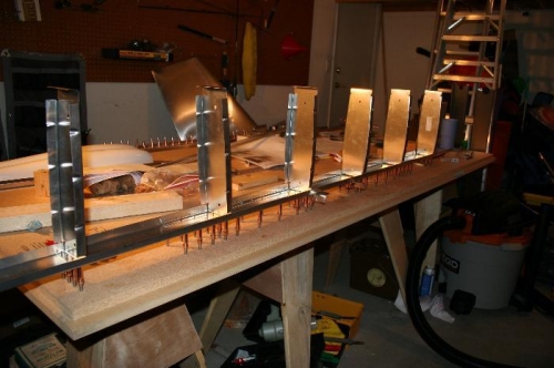

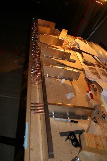

Marked clamped and drilled all ribs to front spar
Marked all ribs with rivet line.
alligned fronts and clamped to front spar.
drilled all center ribs onto front spar, ensuring they were opened outboard.
