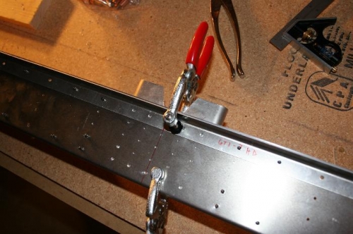

Drilled Shim and cleco'd to the rear spar.

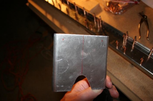

marked the center line on the Shim 6T2-6HD
clamped the shim to the spar...lined up the top edge of the shim to bottom edge of the doubler.
drilled and cleco'd 4 holes thru the shim.
filed a radius on the 6T2-3 attachment to allow max clearance against the doubler 6T1-6HD.
clamped the 6T2-3 ready for drilling.
