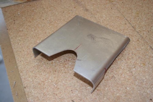

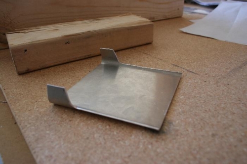

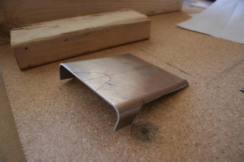

Cut Rear Spar attachment per the drawings
first cut the sides of the part...was difficult because of the thicker aluminum.
filed the sides to achieve the proper radius in the curve...this tool a while.
cut the notch for the elevator cable...this tool a little longer filing to get the proper radius
ensured approximately 3mm clearance to the height of the side flange (note..what is the tolerance of approximately?)
