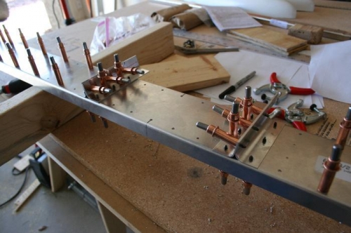

6-T-1A pg 7 - 10
attachment 6T2-2 and 6T2-1 to front spar
clamped the plywood template to the front spar matching the center line
clamped the attachment doubler 6T2-2 at the ends of the plywood template
verified edge distance of the spar to doubler
drilled and cleco'd 6T2-2 (used #30 drill..undersize)

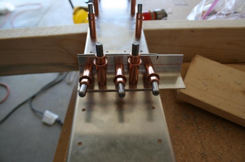

clamped the front spar attachment 6T2-1 to the side of the atachment doubler 6T2-2
ensured the tops lined up
drilled and cleco'd 6T2-1
disassembled the 6T2-2 and drew a rivet line, and marked three rivet drill points
re-cleco'd and drilled the 6T2-1 to 6T2-2
