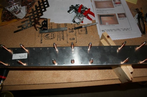

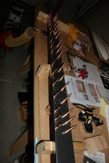

drilled the doublers on the front spars
raised the spar for drilling.
drilled the doublers starting in the middle and cleco'd every other hole.
then drilled between the cleco's
(used a #30 drill bit...undersized as per instructions)
extended the rivet line with a square for the attachment doubler 6T2-1
