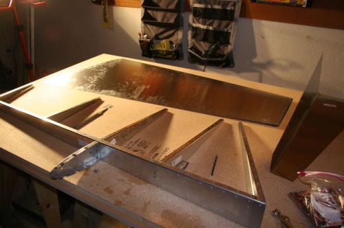

Dissassembled rudder and prepared for reassembly
Disassembled cleko'd rudder.
Deburred all holes, inside and out.

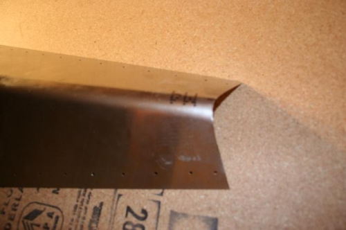

Cut the nose skin on the top edge where marked as per instructions..cut to remove line.
filed cut to remove sharp edges.

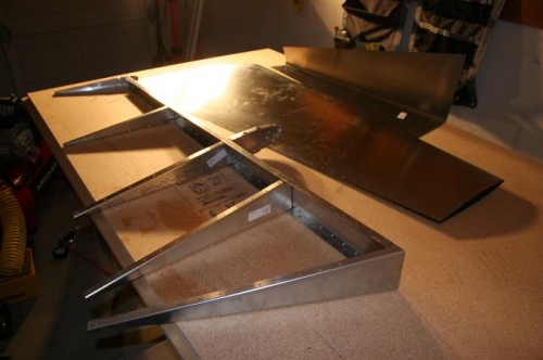

Cleaned all parts in preparation for cortec primer.
Primed all mating surfaces with cortec.
Parts will be ready tomorrow for reassembly in preparation for riveting.

top of nose skin trimed as per instructions
all parts cleaned in prep for painting
