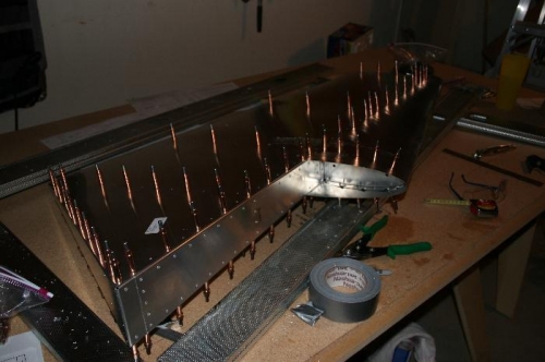

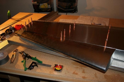

Fitted the nose skin. drilled and cleko'd
Fitted the nose skin under the trailing edge skin.
Was difficult at first to get it tight against the ribs, but finally were able to adjust and tape.
drilled starting in the center and working out as per the instructions.
took extra time making the rivet line for the nose rib, and again extra time to drill as the nose rib did not want to cooperate.
finally finished things off on both sides, and thats it for tonight!
