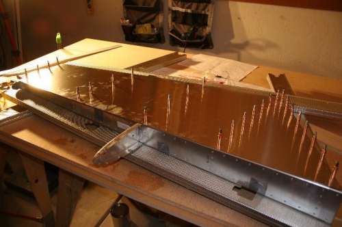

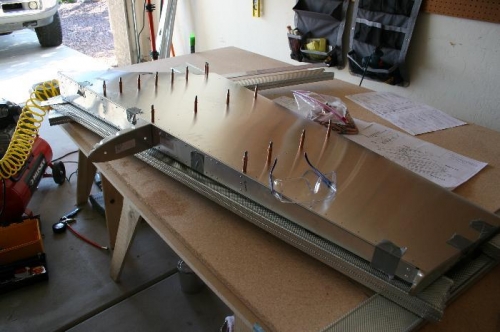

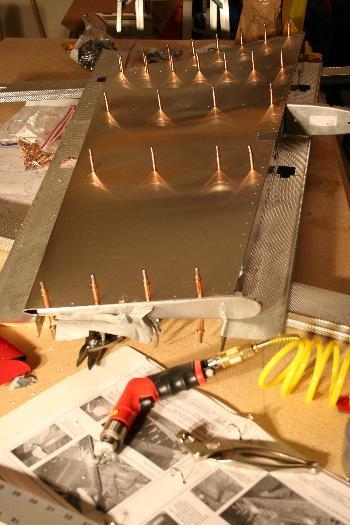

Drilled and Cleko'd Trailing edge skin
Fitted and shaped the ribs inside the Trailing Edge skin
ensured the 3/4 in spacer was always on the trailing edge lower side
used 4 metal studs for elevating the rudder
taped skin in place.
drilled each rib as per instructions in the manual and drawings
