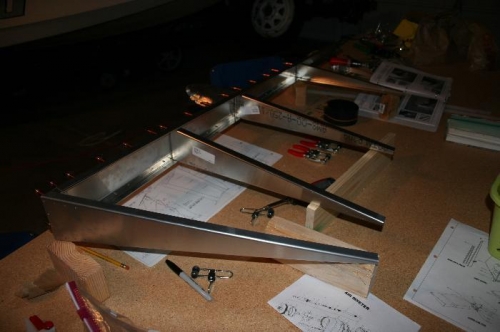

Drilled and cleko'd rib 2, 3 and 4 and nose rib.
Directions as to orientation was confusing (open side of rib up or down?)
Then found dashed line on drawing to indicate rib orientation.

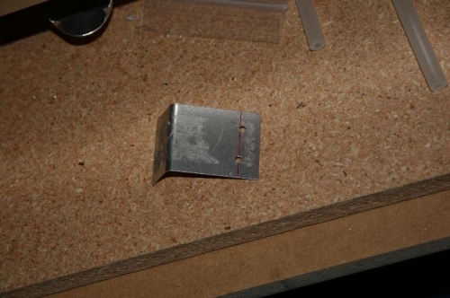

When drilling the bent strip, the second hole moved the piece off the line...(6T5-5)...drilled hole in wrong spot on bent strip (not spar)....this part will have to be re-ordered. Also, one of the red clamps broke.
