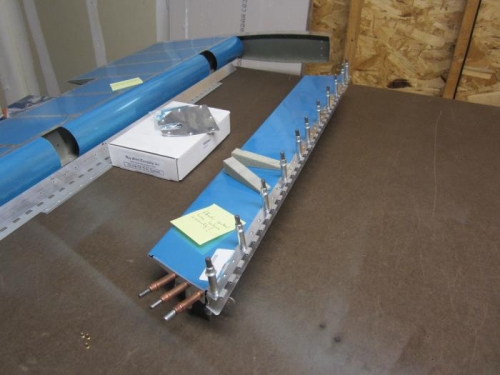

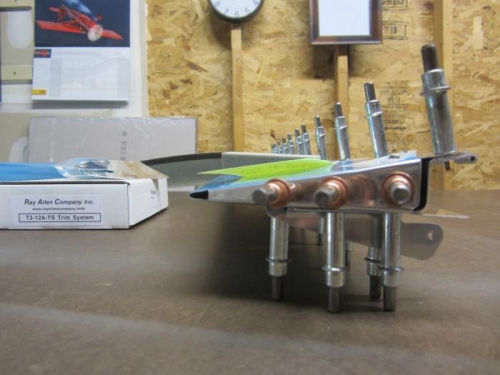

Completed end bends by utilizing the end blocks I created. LL: Do not allow the top block to hang over the trailing edge as it will crush the trailing edge. End product was acceptable, but not great. Another set of hands may have helped, but I doubt it. I checked with my QC guy (Dad) and he said the ends were OK. Drilled holes at trim tab ends. Drilled, deburred and countersunk/dimpled trim tab assembly.Ready for final assembly.
Ready for final assembly!
Right end
Right end
Left end
Left end
