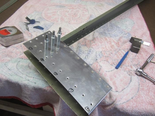

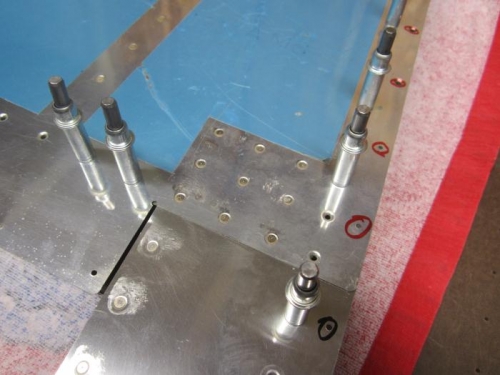

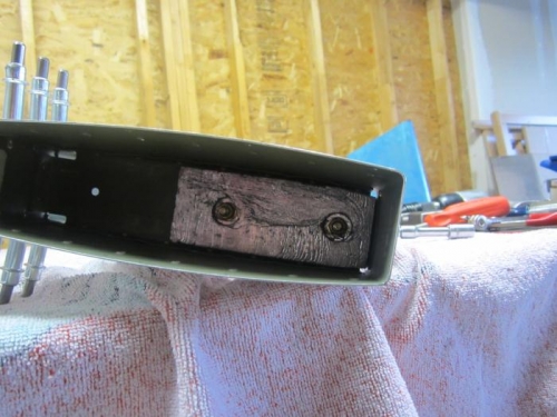

Riveted counterweight skin to rib. Installed counterweight (I sanded the front sides down to in order to ensure a tight fit). Also, riveted main skins to counterweight skin as well as spar (bucked rivets as squeezer will not reach these rivets). Finally, I riveted (LP4-3) the top rib to the spar.
Rivet counterweight skin to rib
Riveted main skins
Riveted main skins
