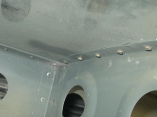

Brief Description:  Flipped Sides on Horizontal Stabilizer
Riveted spar to skin on opposite side of right horizontal stabilizer. Using new procedure (me bucking and partner shooting), we had no problems attaching the tabs. Also, Van's suggested that we use emory cloth on the jagged tabs in order to remove any potential for fracture. As such, we sanded the broken tabs with an emory cloth.
Lessons Learned:
-When holes do not align, use a punch to gently bend the metal into alignment
Sanded broken tab
Sanded broken tab
Other sanded broken tab
