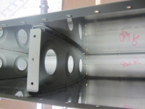

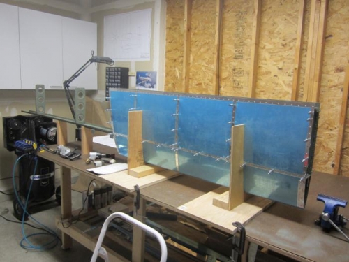

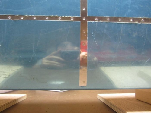

Riveted right horizontal stab nose ribs (bucked with Shannon doing the bucking), attached middle ribs to front spar (squeezed), clecoed front spar/middle ribs to skin and clecoed outboard/inboard/center ribs to skin. Next, we will attach the inboard (bucked), outboard (squeezed) and center (pop rivet) ribs. Then, the skin will be riveted to (1) front spar and (2) ribs.
My current concern is attaching the inboard rib. Either we will need to buck it from the back side (either lay the stabilizer on its side or invert the stabilizer) or I will need to temporarily un-bend the rib in order to use the rivet in a traditional manner (vertically). I am undecided.
