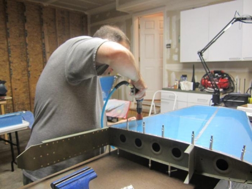

More Lessons Learned:
-Start at center and work to edges when completing riveting
-Buck rivets which attach ribs to spars
-Buck rivets which attach skin to rear spar where rear spar has a doubler
-Don't forget to remove blue plastic on inside (prior to assembly) and on outside (when complete)
-Manufactured head should be on side with thinner metal
Using the gun!
Using the gun!
More gun work!
More gun work!

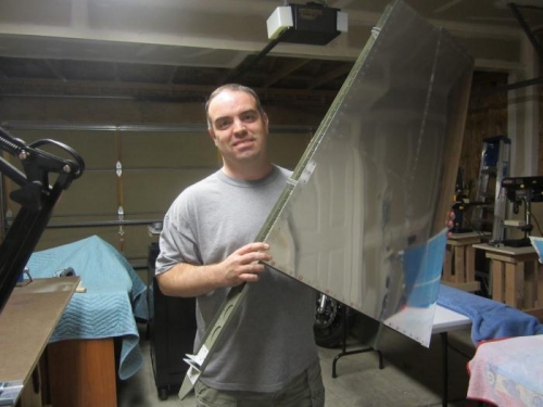

1st piece complete!
1st piece complete!
