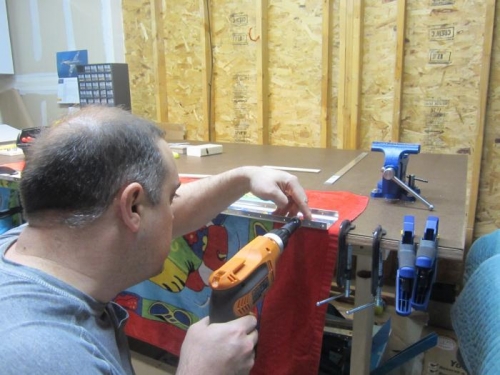

Brief Description:  Started Countersinking Spar
Determined depth foor countersink by utilizing scrap aluminum purchased at Lowe's. The countersink depth is correct when the test piece is flush with a dimpled skin hole. Do not drill such that a rivet is flush in the spar but that the spar is flush with a dimpled skin hole! The hole will be much deeper than a flush rivet hole as the dimpled metal on the skin needs to sit in the countersunk hole. Countersinked first spar piece.
Countersinking spar
Countersinking spar

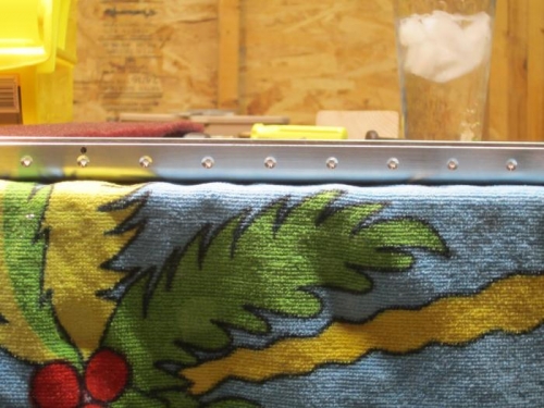

Finished product
Finished product
Another shot of finished product
