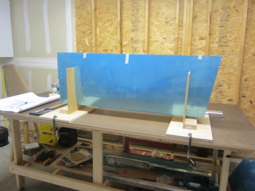

Brief Description:  Built Jigs/Inserted Right Skin
Cut jigs with band saw. Then, attached jigs to 2x4s which are attached to 3/4" plywood. The jig assemblies are clamped to the work bench. Additionally, I inserted the right skin in the jigs. However, prior to inserting the skin, I test fit the jig on the skin which resulted in an oil-can situation! Not good. Always inert skins into a pair of jigs. That being said, according to my father, this is not a huge deal as it will most likely not be noticeable. If it is noticeable, the dent can be fixed with bondo prior to painting.
Finishing jig assembly
Complete
Complete
Right skin in jigs
Right skin in jigs
