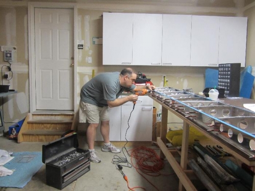

Brief Description:  Cleco and Drill Ribs to Front/Rear Spar

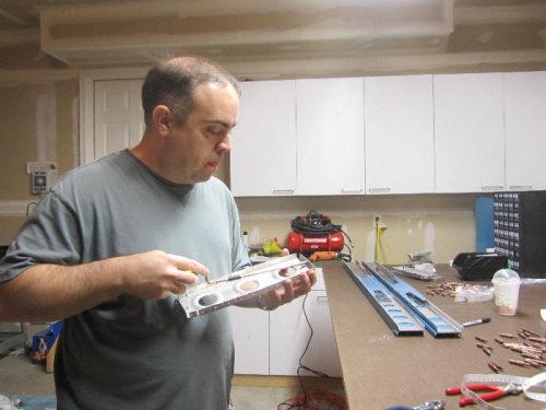

Clecoed and drilled ribs to front spar. Next, clecoed and drilled ribs to rear spar. During this activity, I finalized the flange bend of the two inboard nose ribs. Once drilling/bending was complete, I disassembled and de-burred ribs, hinges and angles. Also, I verified that the rib flanges were square and the rib skin holes are aligned. I will remove the blue film from the spars/spar doublers and debur them tomorrow. Finally, I continued to mark all pieces so reassembly will be easy.

Drilling
Drilling
Deburring
Deburring
