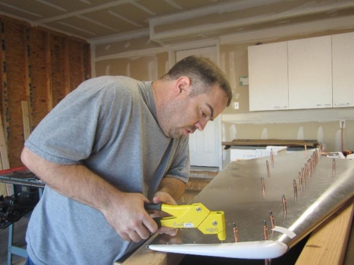

Brief Description:  Riveting and worked nose skin
Started riveting and worked nose skin to reduce/eliminate dent due to bending the skin at the leading edge and not the trailing edge. Completed one side and 1/2 of other side. Lesson learned: do not hand rivet skins! Fatigue and quality (squeeze force=scratches when riveter slips off head) are substantial issues. Rudder should be complete tomorrow ;)
Hand riveting skin
Hand riveting skin

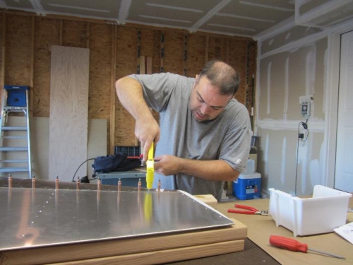

More hand riveting skin

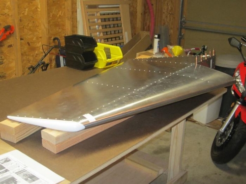

One side complete!
One side complete!
