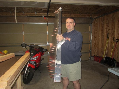

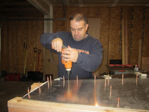

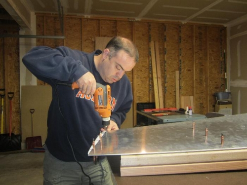

Finished drilling and clecoeing rear skin. A mishap occured when flipping the rudder as a cleco was bent over while attached to the skin. I tried to hammer/massage the rib and skin to smooth out the blemish. I was somewhat effective. That being said, the skin is slightly dented and the rib has a minor bend. At this point, I am going to proceed as-is. Attached the nose skin with duct tape (not as easy as it sounds) and drilled/clecoed the nose skin. In the future, triple the number of clecos Zenith suggests as I am substantially short.
Rear skin finished
Rear skin finished
Drilling nose skin
Drilling nose skin
