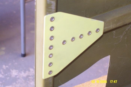

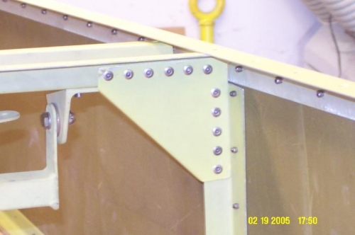

Brief Description:  Riveting fuse primary struct. & clips.

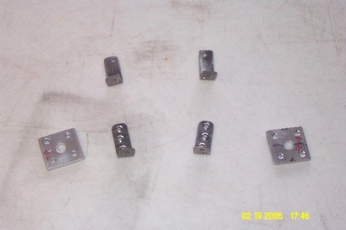

Continued Riveting primary fuselage structure i.a.w. pages 13-16 of manual. finished crossmembers and started remaking clips to fasten longerons to rear fuselage bulkhead. Ones supplied with kit were very rusty and other builders experiences showed cracking of these clips with shock loads on tailwheel. made them from .040 steel.
