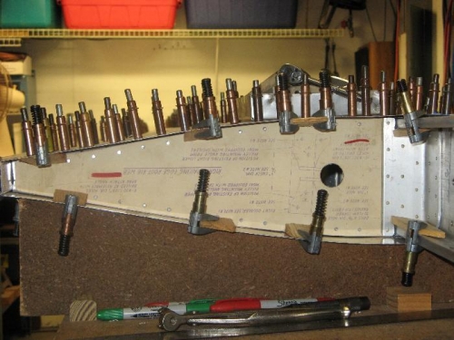

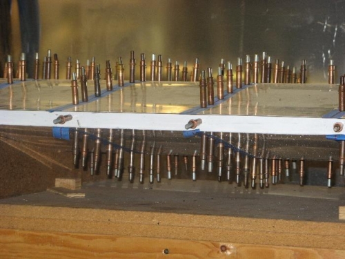

Brief Description:  Finished drilling bottom of right wing
Finished drilling ribs through skins on bottom of right wing as depicted in drawing pages D-16 through 19A. Then started installing root rib reinforcement modification as instructed in SB 004 from MEA dated 4/30/86.
Many many holes drilled
I know I can do every other hole!
Root rib reinforcement
