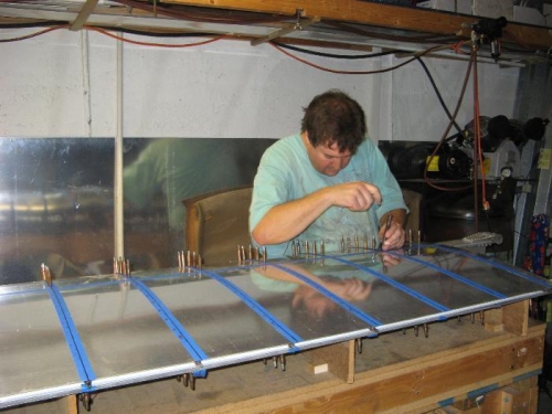

Drilling bottom of right wing

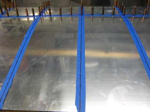

Laid out rivet lines with masking tape then drilled holes in skin only. Then went back and drilled rib flanges through holes in skin using centerlines on rib flanges to align holes as depicted in drawing pages D-16 through 19A.

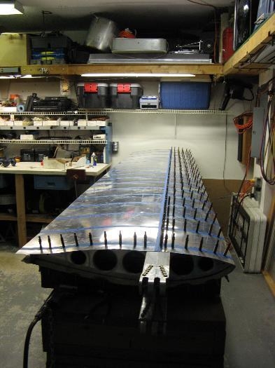

Drilling through to ribs
Lots of rib tweaking required
Half way there
