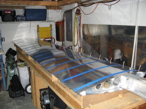

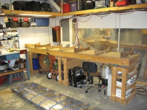

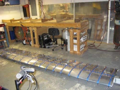

Completed drilling ribs through skin holes in top surface of Rt. Wing. Replaced wing saddles with taller ones called out for bottom side construction (to clear clecos in top surface) and flipped wing over and placed back on build table. Now I am ready to lay out rivet lines on bottom of right wing for drilling. Depicted in drawing pages D-16 through 19A.
Time to flip it over
Taller cradles to clear Clecos
Time to drill some more holes
