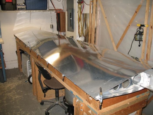

Brief Description:  Drilled Wing Skin

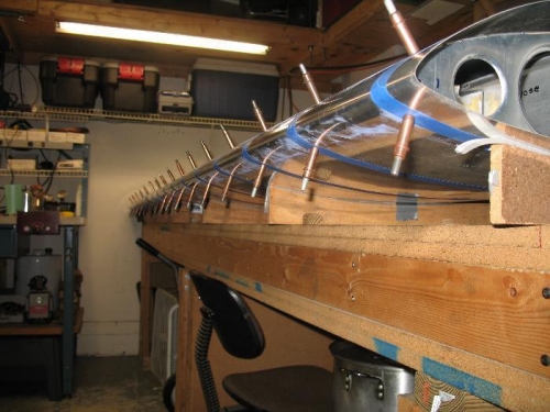

Inserted and aligned wing spar with ribs into formed skin. Drilled root and tip alignment holes and clecoed. Marked line for top and bottom 1st nose rivet and drilled and clecoed all 1st nose rivets top and bottom. Laid out the rest of the rib rivet lines with tape on skin as described in manual pages D-16 through D19A.
Starting to look like an airplane

Nose rivets for alignment
