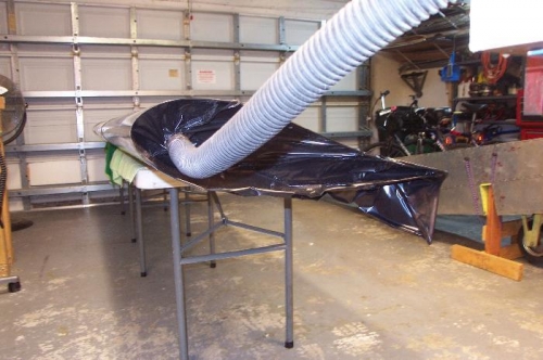

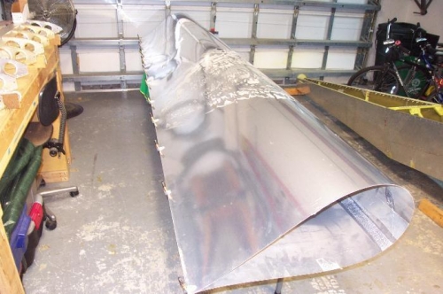

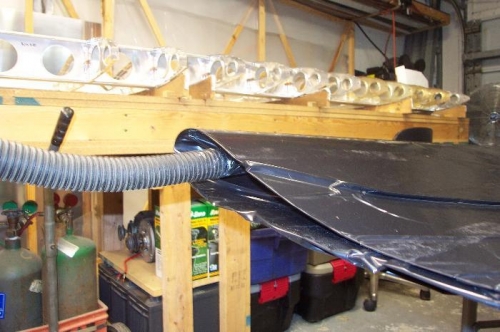

Brief Description:  Formed right wing skin
Formed right wing skin for correct leading edege profile using vacuume cleaner method suggested in buiilders manual. It was really easy and worked great! perfect contour was achieved on leading edge and it was perfectly square with the wing skin sheet. Put formed skin on cradles and inserted spar with ribs into skin.
T.E. Taped firmly together
Sucking it down
Sucking it down
Wow, that was easy!
Wow, that was easy!
