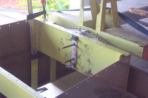

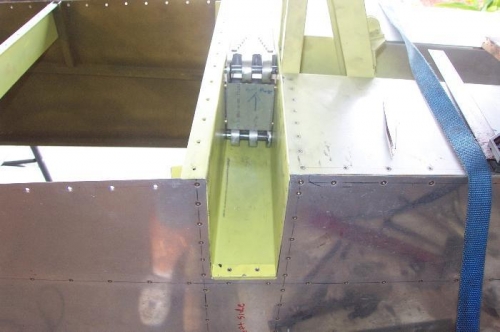

Fit center spar block to spar box
Started fitting center spar mounting block into spar box as shown on page 16. Made center block and template and drilled to mark in assembly as instructed on page 46 step 1.
