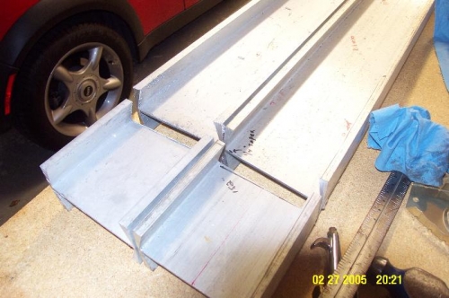

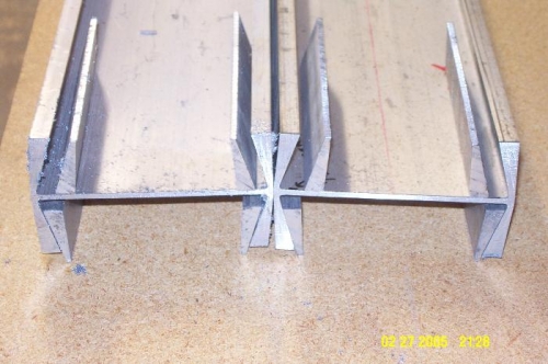

Laid out holes and cuts on spar blanks. Marked position of lightening holes, rib attach holes and cutoff line at root. Then cut root off at appropriate angle and rough cut spar knuckle backup plates from cutoff spar stubs.
