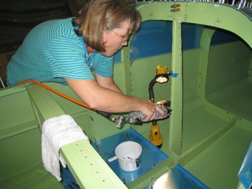

Cut notches out of rear baggage bulkhead for harnes cable and fitted nylon pieces.
Drilled, dimpled & riveted platenuts to baggage bulkhead.
Cut and drilled hinges for seat bottoms.
