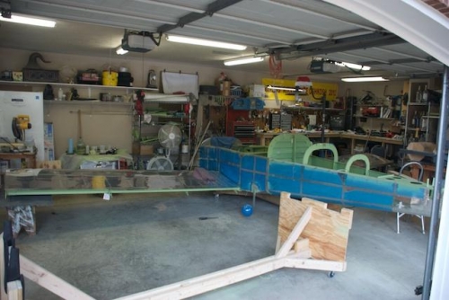

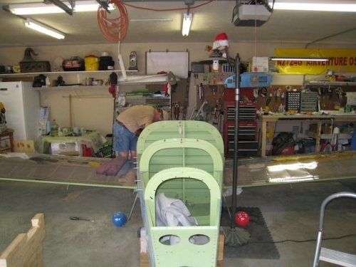

Finished installing pins for right wing the installed left wing and pins. Leveled and verified sweep and inclination angle and drilled aft spar bolt holes on both sides.
