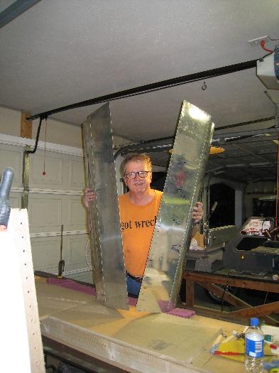

Aileron Trailing Edges
Setup steel angle iron on work table then placed an aileron on angle with sandbags to keep straight. This worked well, trailing edges were very straight after back riveting and the flush setting.
