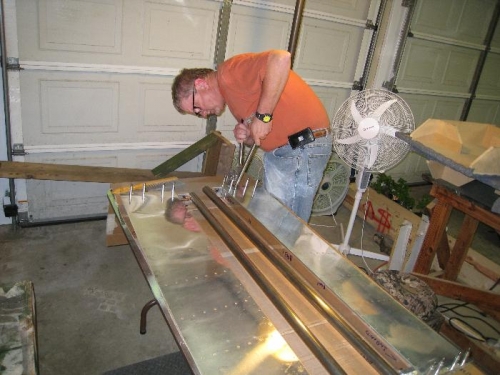

Drilled remaining angles for flap hinge brackets.
Mounted bottom wing skins and drilled bottom of angles.
Removed wing skins and countersunk angles then spot primed.
Clecoed top and bottom skins on both ailerons then clecoed the leading edge skins on ailerons.
Riveted as many flap angles as I could with squeezer then clecoed aileron gap fairings to rear spar and top skin.
Me 3.5 hrs
Beth 2.0 hrs
