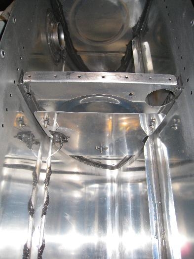

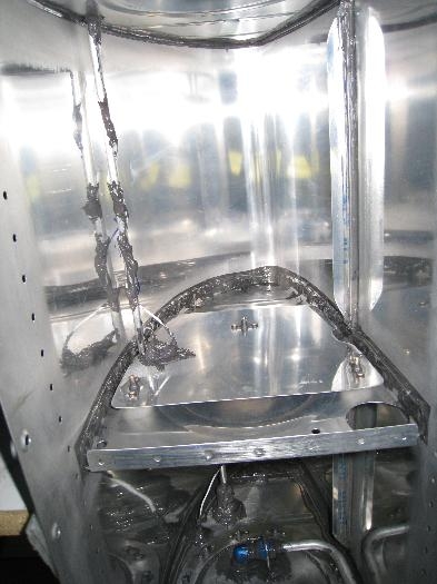

More Tank Prep & Primer Prep
Connected the capacitive plate wires then prosealed the connected area.
Prosealed wires to vent line and vent line grommets to the ribs.
Deburred, scuffed, dimpled & edged wing walk doubler.
Masked off left fuel take and scuffed for primer.
