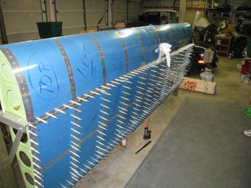

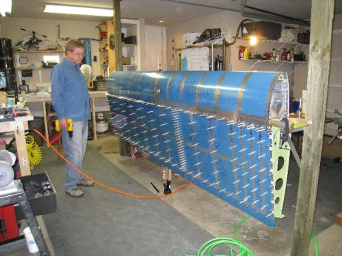

Attached Tank to Left Frame
Temporarily attached the tank to the wing frame with screws every other hole and one or two bolts connecting the tank to the main spar.
Finished clecoing every other hole in the top skin.
Cleaned clecos from the previous nights hell.
