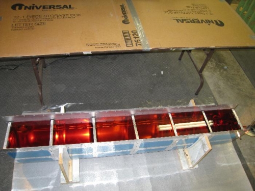

Setup tank for initial leak check by plugging the vent and pickup lines and then filled with water and red dye... NO LEAKS so far.

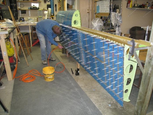

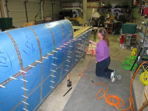

Clecoed primed wing skins back on to the wing frame.
Paul 1.5 hours
Beth 1.0 hours
