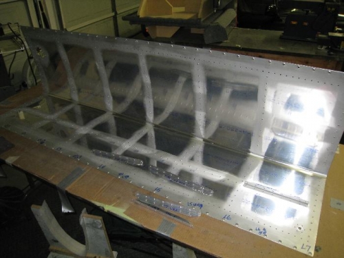

Getting Left Tank Ready for ProSeal
Used soldering iron to score blue film on tank skin then removed rivet area.
Deburred tank skins.
Dimpled tank skins with special tank die then dimpled screw holes.
Deburred and scuffed tank baffle plate.
Scuffed skins where ribs attach.
Dimpled tank ribs.
