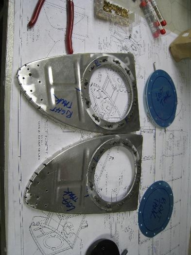

Riveted platenuts and reinforcement rings to both inboard tank rib.
Dimpled all ribs on right wing frame.
Took replacement 904L from left tank and reamed out, deburred, scothch brighted and drilled holes for capacitve fuel sensor.
