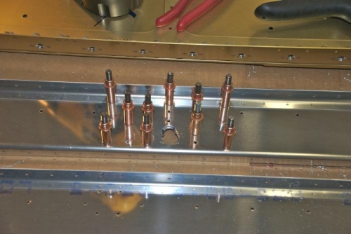

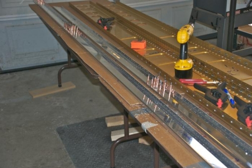

Filed tooling marks of of reinforcement fork the deburred rear spar, doublers and fork.
Clamped, match drilled and clecoed doublers and reinforcement fork to rear spar.
Used Drimmell tool to match the holes in the doublers for the aileron pushrods to the holes in the rear spar.
Deburred holes and started getting the parts ready for primer.
