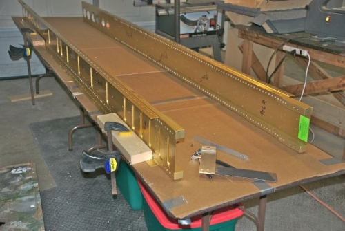

Main Spar Platenut Prep
Marked both main spars for orientation then started drilling and countersinking the mounting holes for the #8 platenuts that allow the tank to mount.
