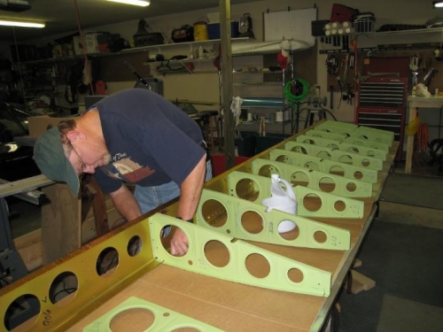

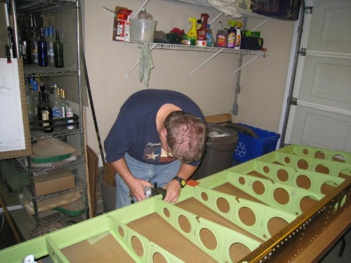

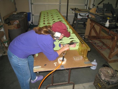

Riveted Wing Skeleton
Clecoed primed ribs to front and rear spar the bucked the rivets on the front spar and used pneumatic squeezer to squeeze rear spar rivets. Only drilled out three rivets in main spar.
