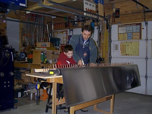

Clecoed and Rivet Stabilizer & Elevator frames (October 2001)
Skins placed on the Stabilizer and Elevator frames - partially riveted to allow for pre-cover inspection
all holes deburred and Zinc Chromate placed on one of the mating pieces of metal
Elevator and Stabilizer completed by the end of December 2001

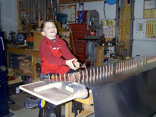

Patrick 6yrs old placing clecoes
