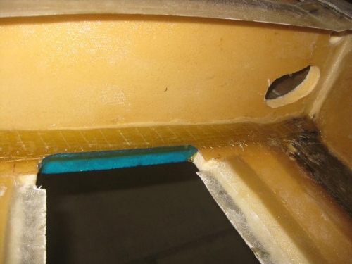

Cut and bonded lower roving laminate
Cut 7 layers of unidirectional fabric and layed up in place on the inboard side of the C Rib.
