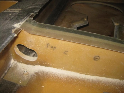

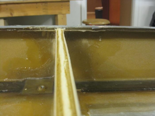

Prepped C Ribs for rib caps
Cut chamfer trough down the length of the C Ribs...this will be filled with milled fiber/resin mix for bonding the C Rib caps.
Chamfer cut out of foam in C Rib
C Rib cap test fit
