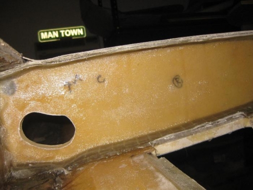

C Rib Laminates
Layed up 2 layers bidirectional cloth over C rib and roving laminates. Trimmed and cleaned up edges of cloth at green cure stage.
Both sets of laminates are covered with 2 layers
