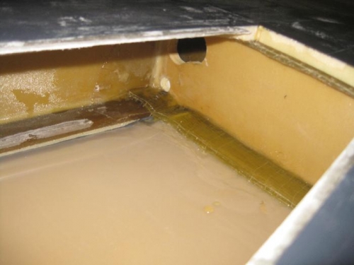

Brief Description:  Roving Laminates
Worked on C Rib laminates. Layed up 5 layers of unidectional cloth on C rib spar cap. The wing was rotated upside down so that the laminates could be layed on the upper underside of the c rib cap. This made it much easier than fighting gravity trying to make the layups stick upside down.
Lindsay helped cut the fabric
Right wing, looking outboard
