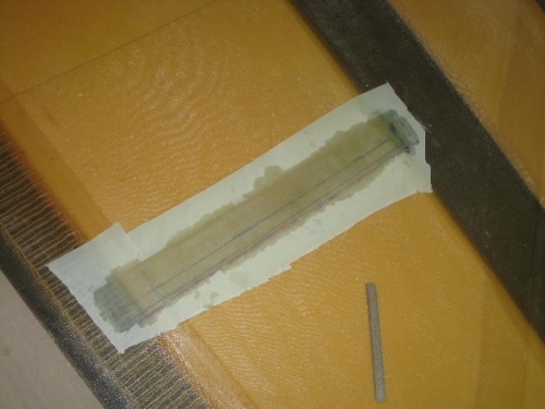

Layed up C Rib Spar caps
Removed top wing panel and taped, laid out C Rib caps. 2 Layers, 45 Degree bias.
19" stretches from spar cap to spar cap along C Rib
Used wing as mold and clear plastic tape for release
