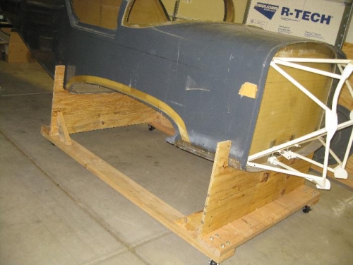

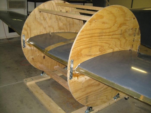

Constructed wing rotation cradle. This is necessary with a Glasair because the wing is one peice and you need to be able to work on the top and bottom of the wing, as well as move around the shop. I can rotate the wing with just one person. Fuselage cradle is necessary to keep it off the floor and move around the shop, etc. I suspec this cradle will be modified after I install the engine, etc.
Rotating wing cradle

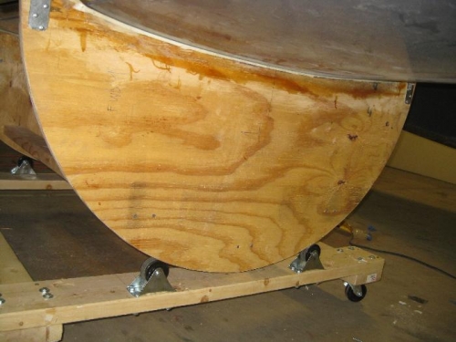

Detail of lower fuselage contour and wheels
Basic fuselage cradle for moving and storage
