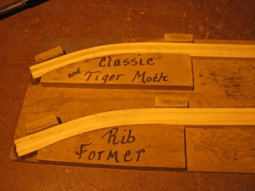

Brief Description:  Started to pre-bend wing caps
The cap strips on the upper part of the ribs and sub-ribs need to be prebend to keep stress out of the ribs. This is done by soaking the capstrip in water for approx 4 hours and then putting them into the bending jig. The exact bend is not critical, just so that it is somewhat close. It makes building in the jigs much easier.
Jig used for prebend
Results after the ribs dry for a day
