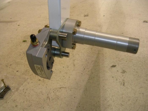

Brief Description:  LG - INSTALL GEAR (#104)
Installation of main gear. removed plug from top L/H side and installed fitting for brakes and capped.Lifted fuselage and placed gear close to position,installed 1/8 rubber pad and lifted gear into position,another pad and then bracket and washer and bolted in place.Installed striker stud and bolted to longeron..Clecoed side step into position and marked for installing AN3 bolt.Removed and drilled on drill press and re-installed and bolted and riveted into place..
