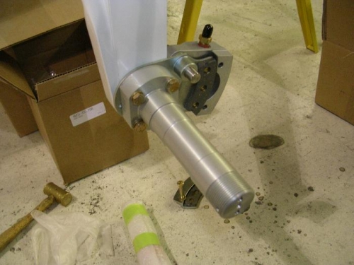

Brief Description:  LG - WHEELS, AXELS, BRAKES (#102)
Located center of axle and marked locations for drilling.Drilled #40,then #30 and final size is #21.Tapped holes to fit AN-3 bolt on L/H and R/H axles. Located center of bracket and marked locations for drilling holes.Drilled #40,#30,#21 and to #12.Assembled L/H side but bolts are to short..
