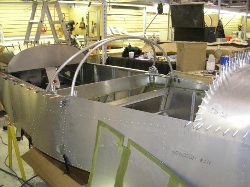

Brief Description:  601 Fuselage construction (#115)
Layed out upper aft skin into position.
Marked out and drilled rivet spacing on Longerons.
Back drilled through longerons and ribs into skin.
Upsized holes to final size.
Researched installation of forward mid upper skin and support tubes
